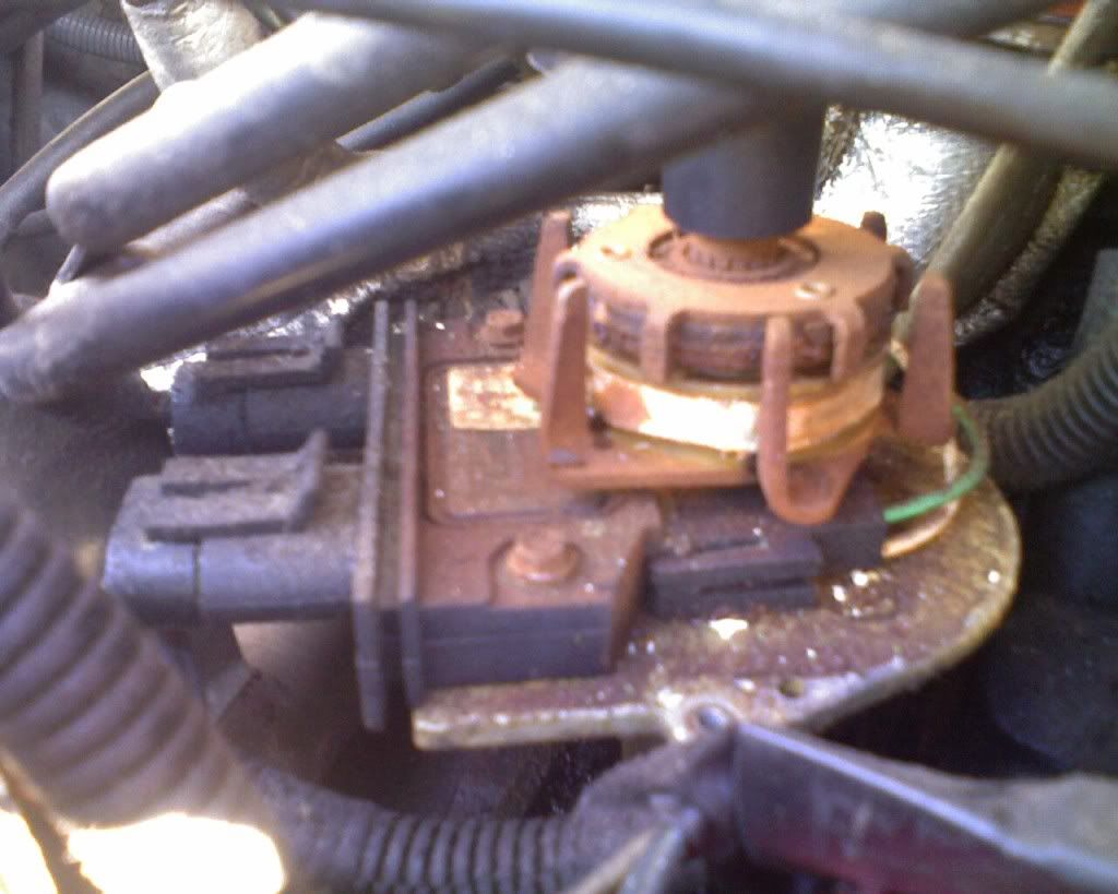

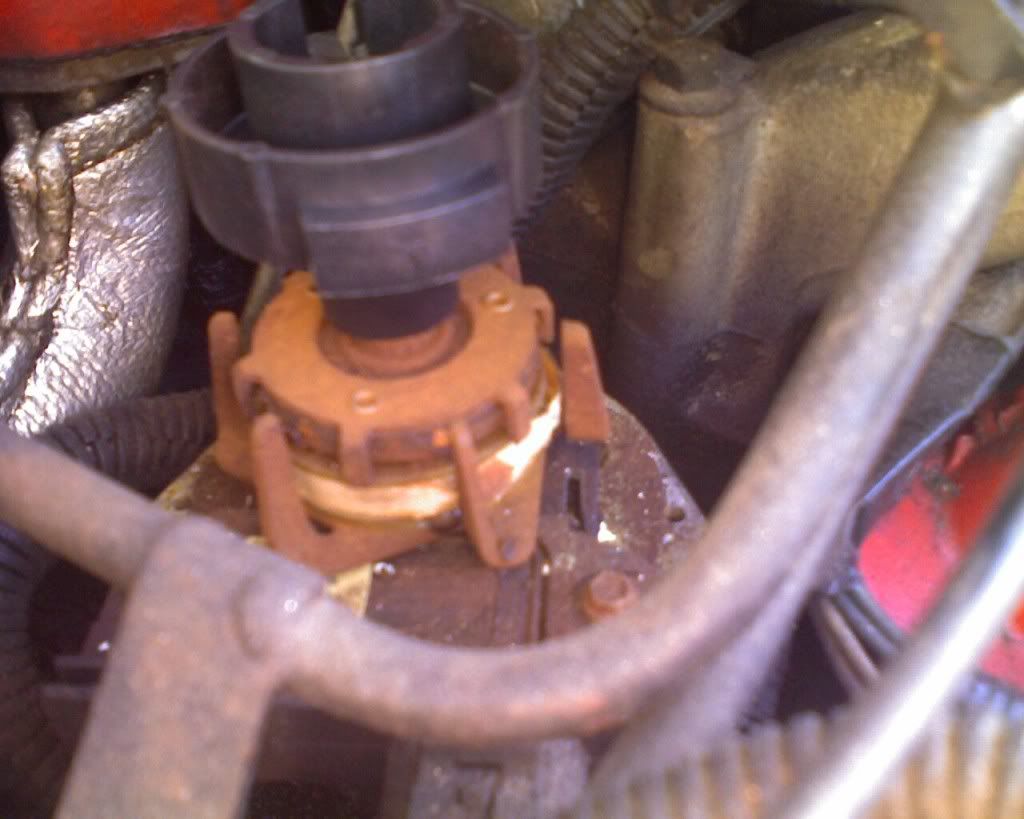

ok heres 2 pics.
So honestly how bad does this look to everyone ellse
