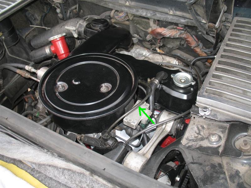

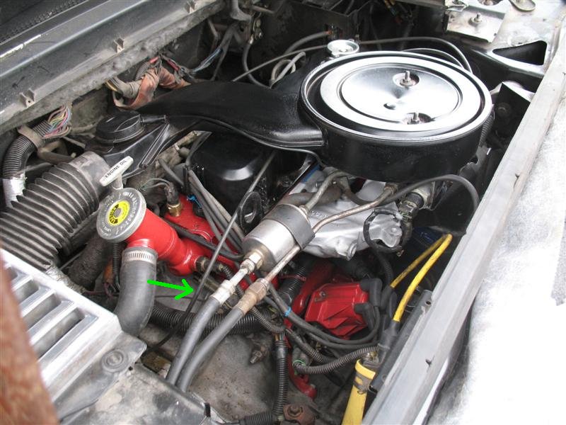

2. can i get a pic of the TV cable to the T.B.I.

The only pics I could find of the TV cable in an 85 I put a new motor in a few months ago.
Look for the green arrow !

thank you every body.
i did not thank of cutting the wire using heat shink then reparing the cut
those pics are what im needing thank you for your guys help
