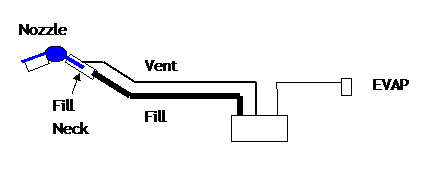

Originally posted by MordacP:
is the vent line connected with the charcoal canister? Could the charcoal canister be the problem?
No... 2 vent lines... Vent line for fueling is next to fill line. Look inside at fill and vent lines near filling cap.

EVAP can, charcoal canister, will not cause this. EVAP system is too small.
And see 22p
Fill Vent is big. Like 1/2 inch I think.
EVAP vent is small... Line is small and EVAP can not move the volume in filling.
Try the idea I already said.
