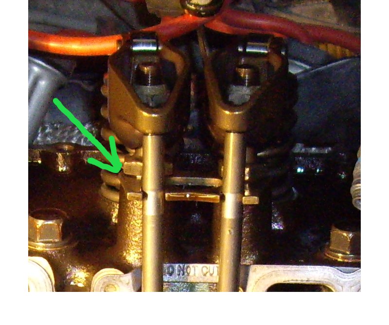

The green arrow points to what looks like one of your studs not being tight to the guide plate. I'd check them all and use Lock-Tite on them to make sure you don't have it happen again.

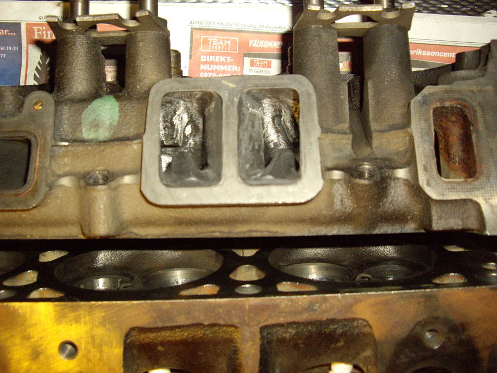

and - also - curious about the prting job - looks like the "shark fin" was removed on 2 of the ports?

Shark fin is not totally grinded away, but its surface is smoothed and i made them somewhat sharper.
Like in this picture:

Maybe I just get one pushrod and one rocker and put it together again, everything else looked so fine.
Cant be any excessive strain really ?!
