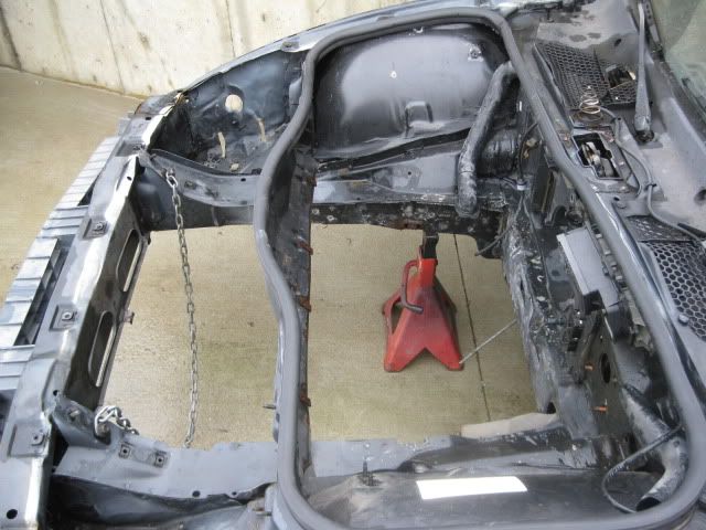

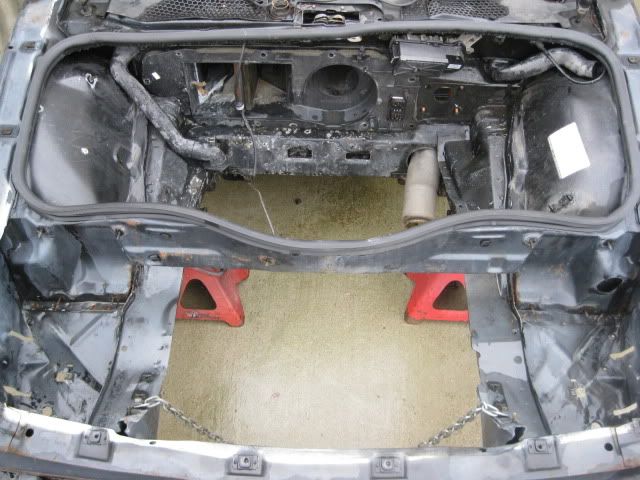

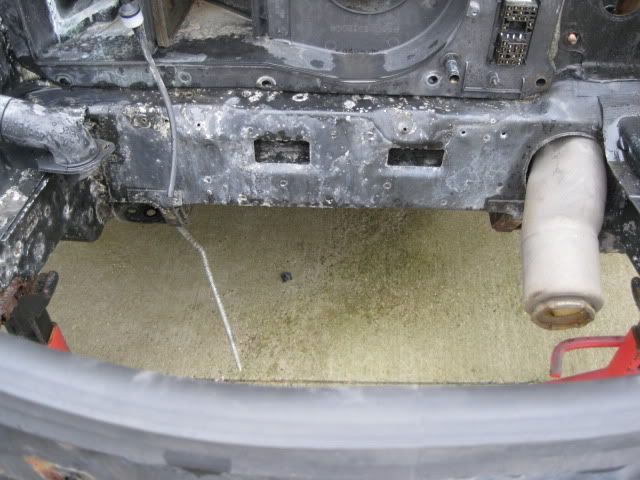

Here is my mock up chassis. Eventually I will put the front crossmember, radiator and locked up 4.9 just to see how it will all fit. I would like to keep the front frame rails stock, but I suspect the crossmember (88) will need some trimming for the oil pan to clear. I am curious how low it could be mounted and with the alternator mounted down low the front of the 4.9 is quite low. The center bulkhead must go.
To make a front engine/rear drive setup, you will have to cut into this bukhead beam for either tranny or torque tube clearance and then weld/seal it all up:
