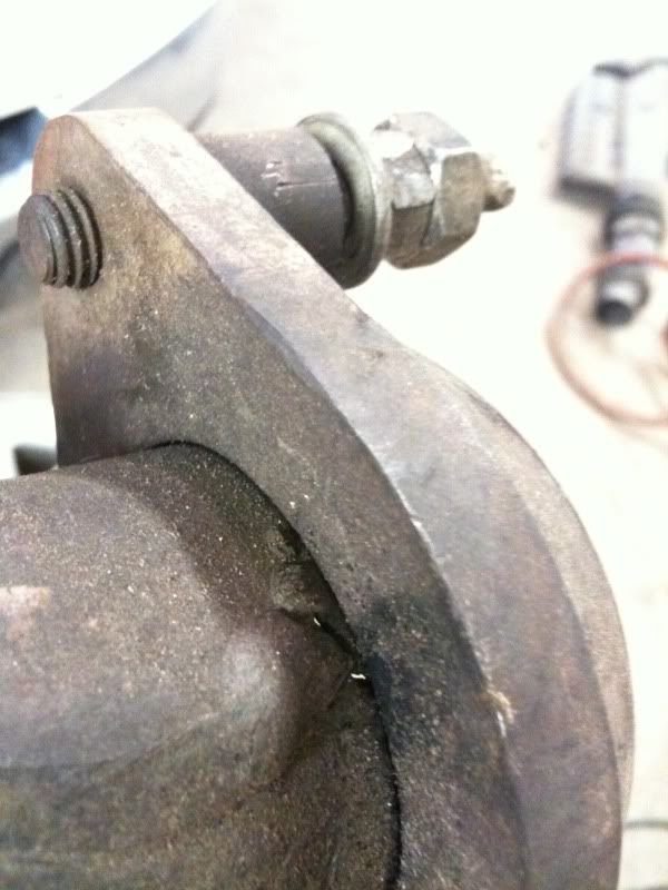

DefEddie
Posts: 1252
From: SALLISAW,OK
Registered: Jul 2009
Report this Post11-18-2009 11:16 AM Click Here to See the Profile for DefEddieSend a Private Message to DefEddieDirect Link to This Post
Here's a better look at the same manifold and the reason for it's R&R.
See the light shining through?
These can also get pinholes,which more what Iwould look for.
Look for the carbon tracing,should be black/sooty where the exhaust is escaping.
braaap881
Posts: 116
From: Chattanooga, TN
Registered: Sep 2007
Report this Post11-18-2009 09:35 PM Click Here to See the Profile for braaap881Click Here to visit braaap881's HomePageSend a Private Message to braaap881Direct Link to This Post
Wow, that's a pretty good picture.. a small hole, but I'm sure that would be more than enough to cause problems. Thanks for point that out.
