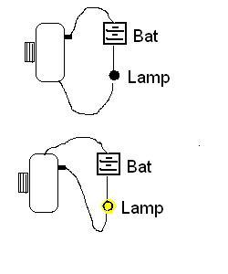

Guess the question is did he see or hear any sparks or arcing. Since it would have been a dead short though the diodes there should have been a good pop if a connection was made.
You could test the alt somewhat with a test light and a 6V or greater battery. Remove the primary alt. wire from the stud. Connect the battery and light in series and then touch the remaining two connections to the large stud of the Alt and the frame. Then reverse the connections and try.
One way they should light the test lamp the other way it should not if the diodes are good.
If it does not light the lamp either way or lights both ways then that might be a good indication that the diodes are compromised.
Not a 100% check but better than nothing.
