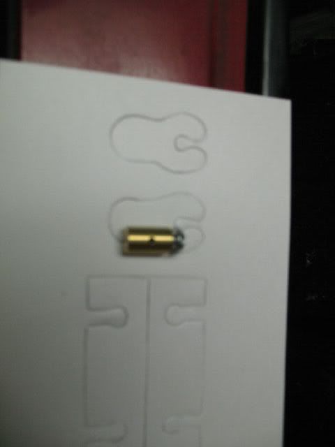

Ok here is the picture I promised yesterday. I have tape on it to try to hold it flat.You can see the factory one,next to it, that I had for an extra.
I have a large flat blade screwdriver with the handle missing. I went back and used it to finish up the staking. It is not gonna come off. I did both sides.
They do not appear to be the same length in the photp, but they are .
[This message has been edited by josef644 (edited 10-24-2009).]
