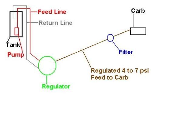

Hmm..... Now I do not know what to do!
I have a picture like this in my head. Am I thinking right?
Posts: 33011
Total ratings: 403
Report this Post10-21-2009 05:13 AM Click Here to See the Profile for Jake_DragonSend a Private Message to Jake_DragonDirect Link to This Post
Thats correct
