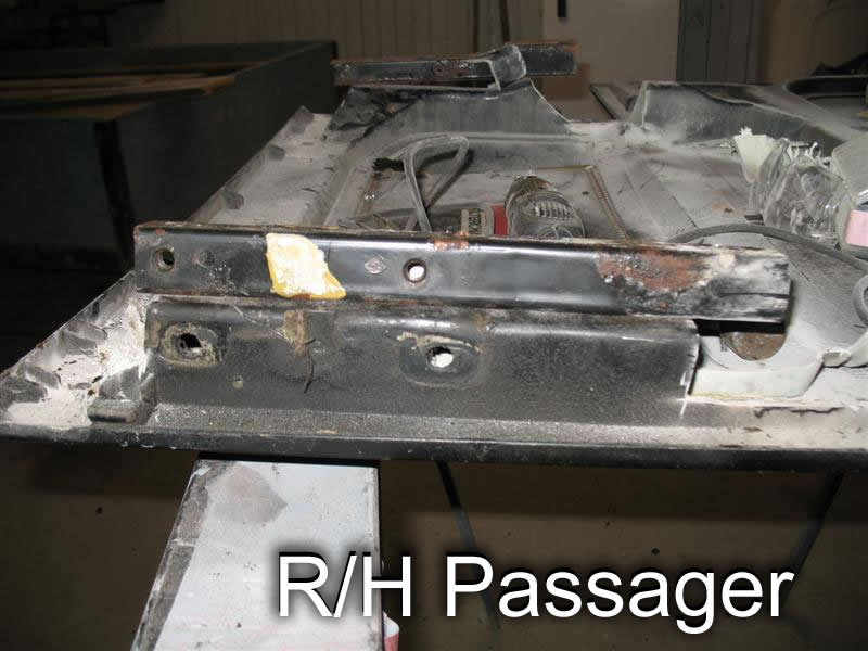

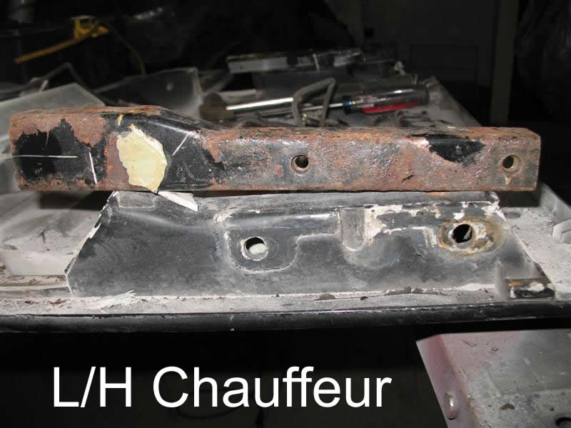

The deck lid has two different L-shaped support bolt holders... the LH side CANNOT be removed by cutting a hole in the top as mentionned by Rodney...due to it's shape it cannot be pulled through the top... a large opening has to be done. (Left hand side of picture) ... the RH side can be removed from the cut in the top it does not have a humped shape.
LH side decklid bolt socket
RH side decklid bolt socket

Danyel,
It seems I will have to go with the larger bolts solution.
This will complicate the installation of my rear decklid strut kit, but I believe it is one of the other pleasure of owning a 21 years old car.
Unfortunately you destroyed your deck lid to demonstrate that. But unless the 85 has a special setup, we all learned something here.
Thanks for your help
