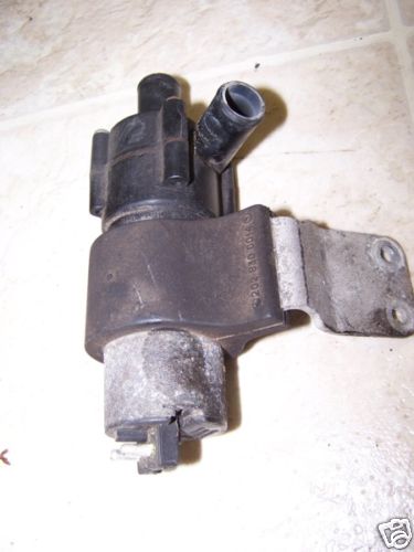

After replacing 2 of these pos intercooler pumps I decided to do some homework and came across a aux coolant pump, These pumps are found on volks wagon GTIs, mercedes benz, BMW, audi and Durangos, This thing is called a auxilary coolant pump they look like these
I got mine from a local junkyard for 5 bucks a peice $5bucks vs $100 bucks = win I also hated my volkswagon radiator for my heat exchanger It was way too big and caused more problems then it was worth (knocking a hole in my radiator) So after looking for a better option I stumbled upon a oil cooler out of a volvo I will get messurments tommorrow but the size was good so I dumped the volks heatexchanger and went with the volvo one,
With the old setup my kr was at 2 and sometimes went to 3 in full throttle and it did not make any sense having a intercooler, I only had a 3.4 pulley My old tune was from loyde and I was using the 97 pcm So it might of been the 97 pcm sucking, I always heard of the 97 pcm sucking when it came to tuning it.
With the new setup Im using a 2001 pcm programed by darth fiero and the new volvo heatexchanger and the new boosh pump And im beating the heck out of it and Im seeing 0 knock
with the old setup the heatexchanger would never get hot but with the new setup it gets hot so its working as intended and doing its job, These auxilary pumps can be used with a pump controller as well meaning it won't kick in till full throttle, The only downside is they are not self priming pumps so you will need a filler resivore (like the coolant one on the fiero) You can get them for 9bucks at discount.

Many of the guys on the Grand Prix forum run the Bosch intercooler pump. They are about $125.00 but they last. The Flojet is a boat bildge pump that is designed for intermittent use.
This is the bosch intercooler pump, and it is commonly had for a few bucks at any junkyard...

This is why the very first thing you should buy for your 3800 swap is a scanner. But really if you know your car then you don't need a scanner as you can tell when it is not acting right.
exactly, That was the very first thing I purchased when my 3800 swap was done, Without it I would of never known I was getting KR, or anything else That scane guage is my engines bread and butter.
The pump I showed on the picture is a bosch pump, It's the same pump that is sold from car sites for $175 bucks, And like DH said they can be had at any j yard for a couple bucks, since the pump uses propellers to ciculate and isolated from the rest of the motor they last a long time, This is something I wish I knew before dishing out $100 bucks on a flojet pump and having it go bad in 4 months then dishing out another $100bucks on a replacement only to have it go out after 3 months.
You can also have them work with a intercooler pump controller, You cannot do that with a flojet, car sites sell the flojet as a intercooler pump as well, So I did not go out trying to find a cheap boat bulge pump the flojet was actually in intercooler kits as well, Sometimes expensive is not the only way to go, And so far this little 5 dollar pump is doing it's job, If it fails I have 3 more to install and a scan gauge to tell me if its not working.
I have had the thing in for 2 weeks so far and its still working and doing its job, I will report back if it ever goes bad, If you don't see a post about it then that means it's still working, Look the pump up and you will see it comes out of alot of cars and these cars use them for many miles.
