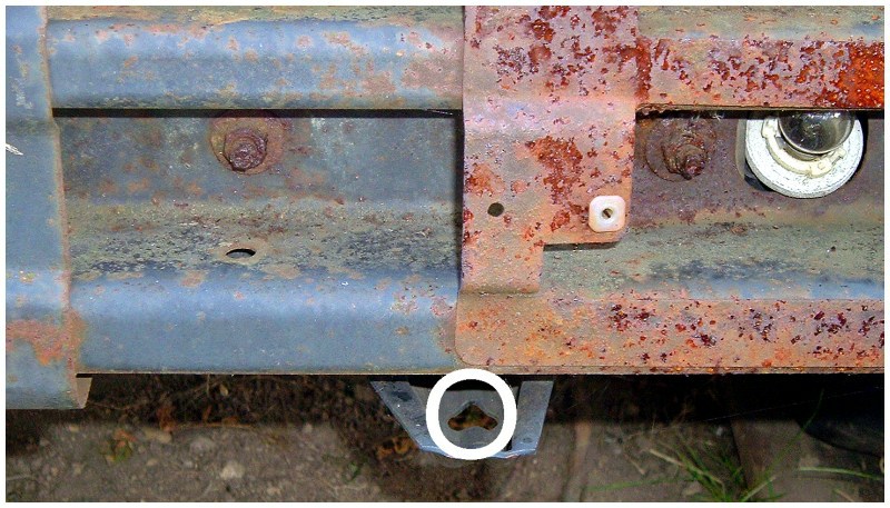

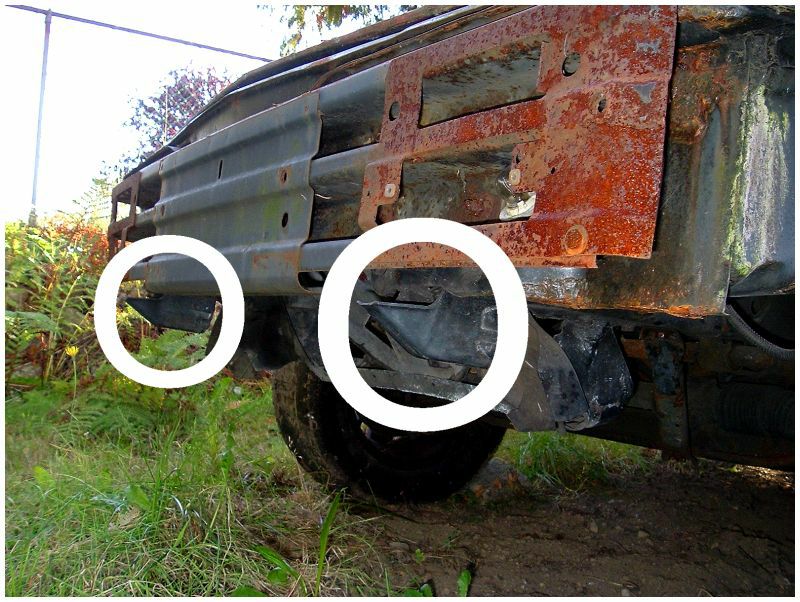

I've taken some pictures of my Fiero parts car and using a large white "O", I've indicated where I think the bar could be connected. However, I've never used a tow bar before, so I'd appreciate some feedback on this.
The two locations are 30.75" apart.
Same places, just a different angle.

Those locations should be good. I've got a towbar that fits across the studs that hold the bumper beam on the car. It's worked well the couple of times I've had to use it!

Thanks Rod. So is it just a matter then of putting a big bolt through the hole on each side into the tow bar? Is a "safety chain" also a good idea?

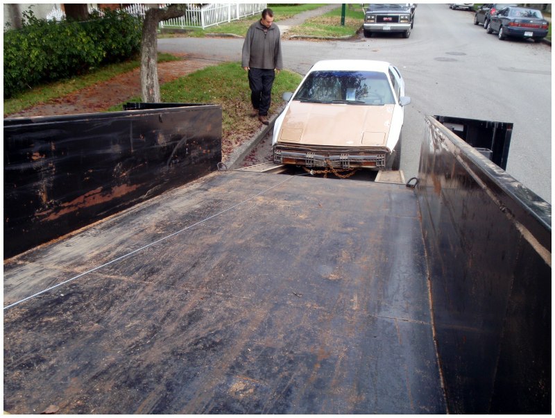

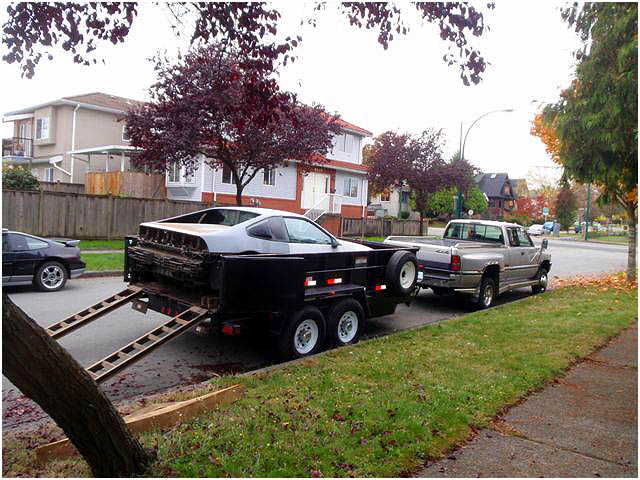

No, I was fortunate enough to have a friend with a trailer bail me out.

Oh, you definitely need to take the nose off. As a matter of fact, I was glad I had taken the nose off even when it turned out we used a trailer. The reason being that we still needed a place to attach a chain in order to pull both Fieros (one per trip) onto the trailer... and we also needed the ground clearance when going up and down the ramps.
Luckily I had taken the back bumper off as well. It was a tight fit!

They are mounted with a minimum of three 3/8" Grade 8 Bolts( coated with Blue Loctite) per side torqued to 85lbs/ft. Even then Blue Ox recommends the use of a choker sling arround the base plate and a seperate frame member.
A single bolt attaching your tow bar ( where you indicate in the picture) might do the job but in the event of a failure you would have no backup
