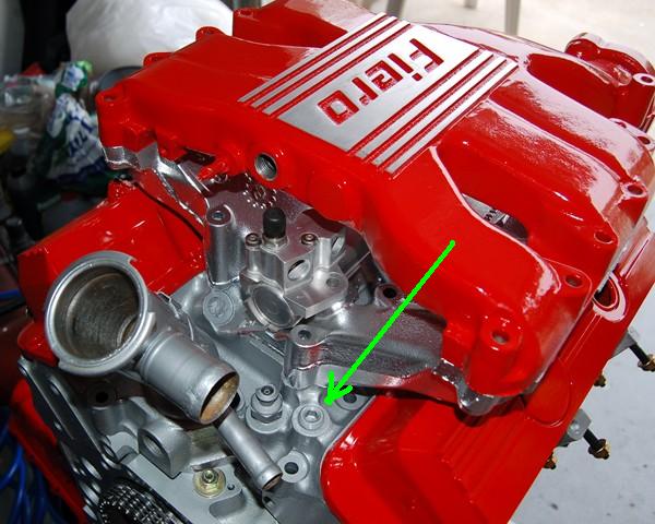

I'm installing a length of braided hose from the 1/8NPT port, (yellow arrow) to a remote oil pressure sending unit that I'll install away from the headers and the cat and then route the wiring behind the firewall heatshield and up through the console to the dash.
I'm using an available NPT port next to the fan switch on the lower intake manifold for the new water temp. sending unit.(green arrow).
The old sending unit on the rear cyl. head and OEM temp. gage will remain in place for now. (I'll remove them later if all the new gages work well)
The new water temp sender *could* replace the OEM one and I might be able to use the original wires in the harness, but I don't like the proximity to the exhaust header.
I think the OEM wiring for the volt gage will work ok for the new aftermarket gage.

Originally posted by Bloozberry:
Ooooh ahhhh... very nice.
Old photos from my 3.4 rebuild last year....
It's still very clean, but not quite *that* clean
Just used the photos to illustrate what I'm trying to do.

Are you not using the stock 2.8L ECM? That "unused" port on the lower intake is for the cold start switch. You got something else going on like a 7730 swap?
