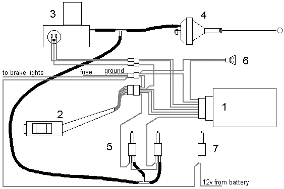

Here is a representative block diagram of a cruise control system:
Key:
1. control unit - usually buried in center console or behind dashboard
2. operating switches - on column switch stalk
3. vacuum pump - under hood, usually next to brake master cylinder
4. servo unit - usually on a bracket over the cam cover
5. brake and clutch switches - half way up the pedal bracketry
6. inductive speed sensor - on the back of the speedometer
7. brake light switch - half way up the pedal bracket
Hopefully this will help you in your troubleshooting efforts.
