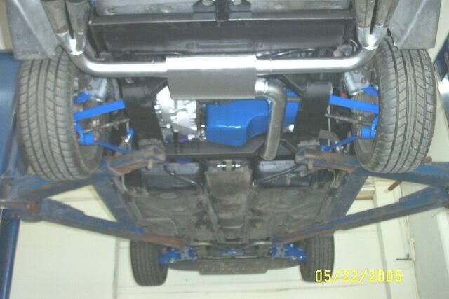

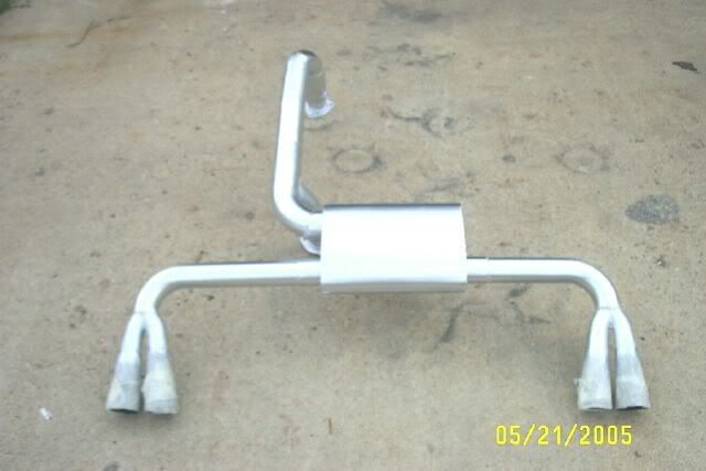

I have ran true duals as well as a single inlet crossflow muffler on my SBC fiero.
Here is the dual 2 1/4" setup with turbo tube mufflers (not glasspacks):
Here is the single inlet setup. 2 1/2" mandrel bends off the manifolds into a 3" in dual 2 1/2" out Flowtech Afterburner muffler.

Report this Post09-21-2009 12:39 PM Click Here to See the Profile for fieroguruSend a Private Message to fieroguruDirect Link to This Post
Originally posted by Old Lar:
fieroguru..How quiet are your exhaust systems?? The V8 Fiero is awfully loud and I need it to be made quieter. What was the cost of the exhaust systems??
The dual setup was much quieter than the single, but I never got a sound clip for it. Here is the sound clip for the single exhaust:
They both were in the $100 to $150 range for the mufflers and mandrel bends and I fabbed them up myself.

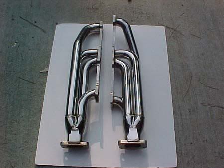

Report this Post09-21-2009 12:46 PM Click Here to See the Profile for fieroguruSend a Private Message to fieroguruDirect Link to This Post
fieroguru
12554 posts
Member since Aug 2003
If you are wanting a really quiet SBC, you are probably best off to start with these turbo manifolds and run the exhaust in the stock fiero format with the cat up front and the muffler in the rear. This will greatly increase the overall exhaust length and help quiet it down (hard to do with 5 feet of exhaust length).

Report this Post09-21-2009 01:12 PM Click Here to See the Profile for carbonSend a Private Message to carbonDirect Link to This Post
It also helps to quiet the exhaust if you populate those two collector flanges with turbos...
