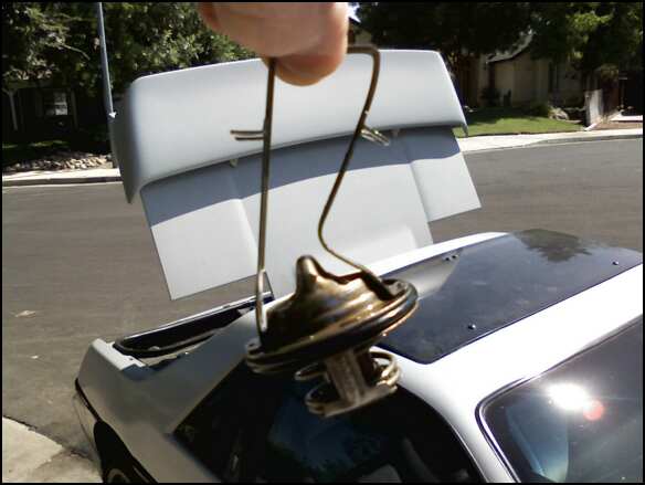

At least not their coolant thermostats. My motor hasn't been able to warm up and idle down for the past couple days so I figured something was up.
I'm wondering if I should claim the warranty or get store credit on a higher quality piece.

You have a heater problem. See cave. Powertrain, engine, cooling, Thermostat.

Have you verified actual thermostat operation by putting it in hot/boiling water with a thermometer?
As for the bend in the retainer bracket...are you sure you didnt force it down the neck opening??

I installed the heater core new last winter and it worked great so I dont think it got clogged. Plus I flushed the coolant so it isn't full of junk to clog it. I lubed the ring with silicone grease and installed it snug in the housing, no forcing. It is more likely that a pipe got crushed so i'll check for that.

Are the "legs" brass looking? I use STANT thermostats - steel legs, never had the problem again.

The frame is steel in color. I think the problem is that it doesn't have much of a rib going down the sides of the frame. The last one I had, which i tossed cause the o ring was gone, had a full 90 degree bend all the way down the legs and it was solid. I remember standing at the counter at autozone, pulling this one out of the box to inspect and thinking, "looks flimsy". I'm still going to investigate other possible causes.

Definitely the autozone thermostat. I got into an argument with the clerk because it was so junky it looked like a pretzel just like yours. Went to advance and picked up a stant thermostat and never had a problem after. MUCH beefier

Is duralast even made in the USA, I'm thinking duralast products are made in mexico. So thats probly my be your problem right there.

I have not had that problem but after replacing two stats in my GP I ask if they had a better grade of stat. Oreilly's carry a standard and a better stat even in Stant. The standard would last about 1 year and start to float open not letting the engine get to op temp. I now ask for the better and so far am two year in and no problems yet. Guess the adage you get what you pay for goes for stats also.

Just to let you know all products at AutoZone have a 90 day warranty no matter what it is. If you go back ask for a fail-safe thermo, it is better and stronger. If the fail-safe does go bad it will stay open and let the coolant flow and not overheat. If you do not like the way you are treated ask for the DM's number.

when i got my fiero i noticed it wasnt getting hot, poped the stat out, and looked just like that, droped a stant in it, never had a problem again.
duralast IS JUNK.

bought 3 stants in 3 months from advanced, didn't bent, but didn't OPEN EITHER ! you say china junk, I've seen alot of usa stuff I wouldn't brag about either ! sad but true.

BWAAHAAAA!!!!! Mine did the exact same thing. I went through three of those worthless Durajunk thermos. I bought an AC Delco and haven't had a problem since.
