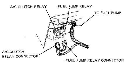

When you first turn the key to ON (not START) you should hear the fuel pump prime for about 2 seconds. If it does not then you can swap the fuel pump relay with the A/C relay on the firewall, drivers side, to see if it's simply a bad relay. Those relays are identical standard Bosch 30 amp relays available at any parts store for about $11.

Yep was the Fuel pump. I really never want to replace one of those things ever again!! Wait, i'll need to do it when I do the 2.5>>>>2.8 switch!
