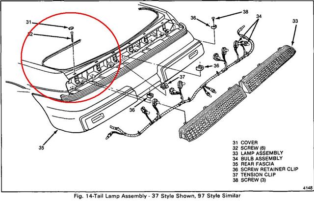

the c in the word pontiac it not lit as bright as the rest of pontia on the rear of my gt. could it be a blown bulb behind the c?
whats the best way to fix it?

Best way is to pull the lenses and replace all the bulbs with brighter ones. they are not up against anything inside the lamp housing so going to the higher wattage same base ones works and really makes the lettering stand out at night.
But from what I remember, it's not perfectly even lighting all across inside there.
In fact if you go to home depot, the yard lighting section you can find up to 18 watt versions of that lamp.

Report this Post09-03-2009 03:14 PM Click Here to See the Profile for Nosferatu187Send a Private Message to Nosferatu187Direct Link to This Post
wyatt,
You probably just have a burned out bulb, some of the light is bleeding over into the "C" letter. Just open the decklid, pop off those square black caps. The screws for the taillights are under those black caps, # 31:
Here's some good info about the various bulbs for the P-O-N-T-I-A-C lights for the '86-88 GT:
http://www.geocities.com/mo....PONTIAC-lights.html
Mike

Just an FYI that sometimes it is not the bulb that's at fault.
Make sure to check the contact pins of the socket the bulbs plug into.
Rusty and/or corroded contacts can allow the bulb to work
but at a reduced voltage. Just something to keep in mind....
