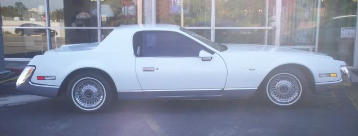

Okay, here's the deal. There's a local guy here that owns a '87 Zimmer Quicksilver. If you don't know what they are, they are the Fieros that Zimmer Motorcars turned into this...
Also as you may know, these were the only Fieros that received some sort of power steering.

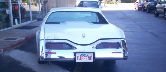

Here's the deal. Apparently I didn't know it with these cars but there is no key for the decklid. The little middle part in the photo above is an emblem and there is no key lock there. The owner met me at a car show after seeing my Fiero and inquired about how to open the decklid because it seems that the only way you can open it is with the trunk popper, but he's told me that also has now gone out and he can no longer pop the decklid open to service anything. I responded that I figured there was a way to jump the popper switch, but I wasn't sure if that was true or how to. I've read through searching that someone has said that you can 'jump' the popper switch and it will allow it to activate, but I'm not sure if that's true or how to do that. I'm guessing by using a paper clip or needle nose pliers on two pins?

It is possible that the solenoid is just bad and applying electrical power to it wont work. I have a F40 kit car that had that problem. I drilled a hole in the back by the trunk latch and stuck a long thin screw driver in, turned it to the right and it opened. You might be able to get access behind the emblem on the back.

lso see if you can get a long screwdriver between the bumper and the deck lid. Look at your own car to measur the exact location of the latch. With the key lock non existant the screwdriver fits in the hole in the latch. Turn clockwise and it opens.
