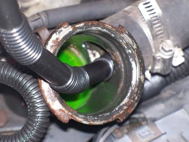

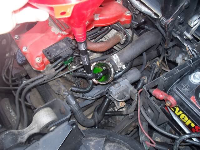

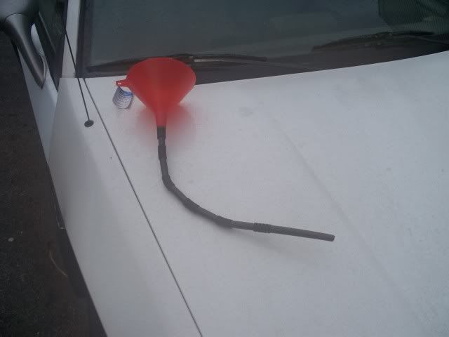

I learned this from back on holiday
This will be your best friend in filling the reciving tube

Nifty, when filling from tstat til radiator is full would it help if the back end of the car is elevated (jack/ramps/steep driveway) putting the radiator below the tstat to more or less force coolant down the lines to the radiator?
That is awesome pontiackid, I'm gonna have to pick me up a funnel like that.
