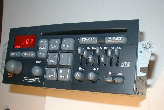

Originally posted by Spoon:
Your probably whipping a dead horse. You might consider upgrading to the Delco Monsoon radio. Has CD player , no tape but its pretty easy to transfer your tapes to cd.
I just replaced my stock radio with tape for the Delco new style.
Spoon
You can get an radio that looks exactly like this one, except it has a tape deck. It does look a lot more modern and goes better with a stock interior in my opinion.
This is my radio.
