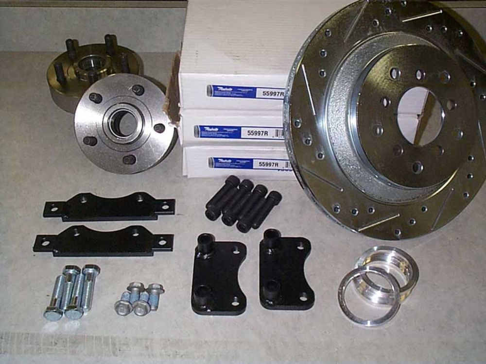

How does it do? I have made one that is 1/4" and it just seems awful thin to me....
This is what I have made.... unfinished but everything fits.
Mike Gonzalez
Posts: 5093
Total ratings: 130
Report this Post07-30-2009 03:29 PM Click Here to See the Profile for Mike GonzalezSend a Private Message to Mike GonzalezDirect Link to This Post
3/8" is what the print says

I am building my own brackets for the 12" rotors on the 88. The backside of the rotor (where it rests against the hub) to the rear wear surface of the rotor is about .360" difference between a stock 88 rotor (used) and a brand new corvette rotor... so 3/8" bracket thickness will have the caliper positions on its sliders very close to the stock position.
For your application, I would suggest doing the same measurement. You want it thin enough to fit and keep the proper caliper to slider orientation, but thick enough to not deflect.
On the 88's you do not need the half moon shape to clear the spindle, a simple peice of 2x3/8" bar stock available at Lowes works and just needs drilled and cut to length.

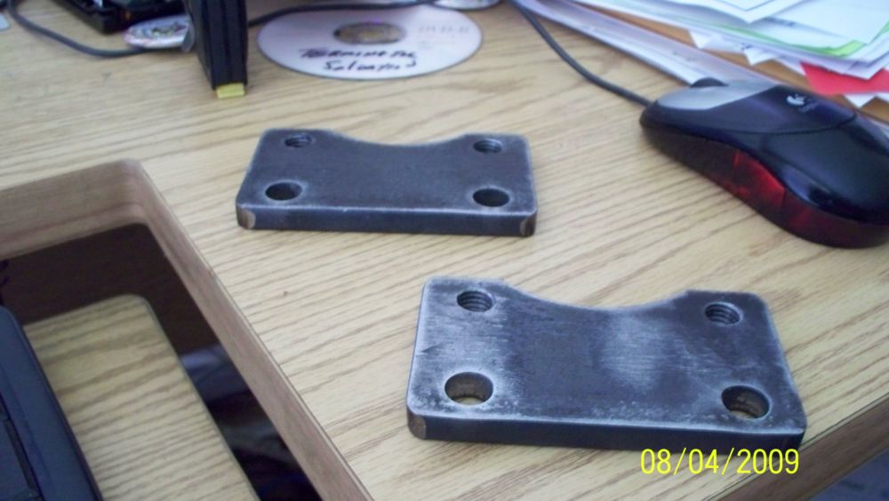

Well, after opting to have my brackets made instead of making them, I am quite happy with what I got from the fab shop. These are 3/8" thick and should hold up the to upgrade.
The 1/2" holes are punched and the others are drilled and tapped.
Thanks for the advice....
