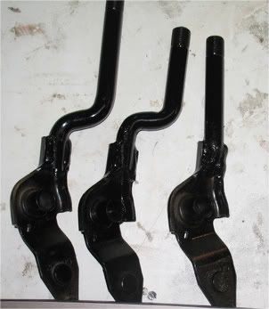

Yours definitely has been modified with a shorter shifter. They're quite a popular modification since the OEM shifter does stick up quite high... altough the longer shifter would actually help with added leverage if you have a stiff tranny or cables.

Yes 94's have a much shorter shifter, this pic show an 86, an 84, and a shortened straight shifter.
Both my 85 and 86 shifted nice smooth and easy, but I also bled the clutch anually and had steel pedals installed.
