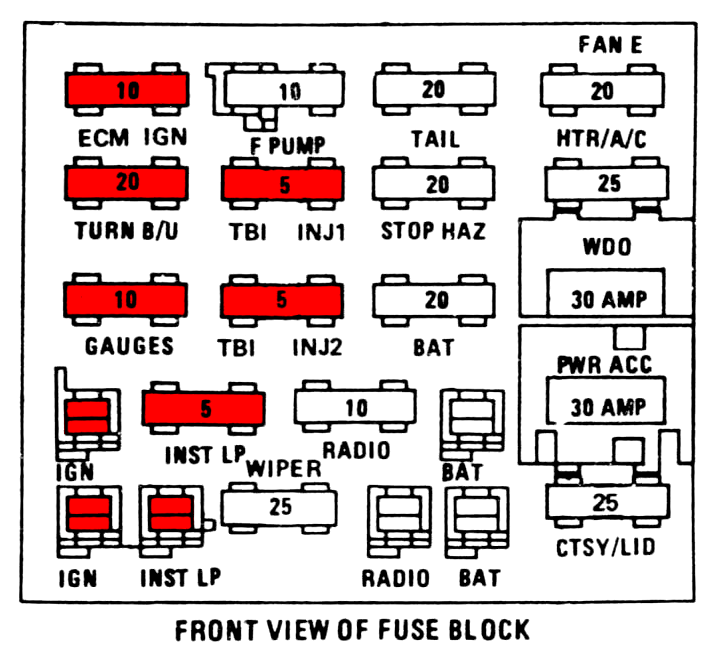

I actually did something similar, I took my voltmeter and measured at the fuse box with ignition switch set to RUN. RED means I measured no power (0V) at both terminals of the fuse:

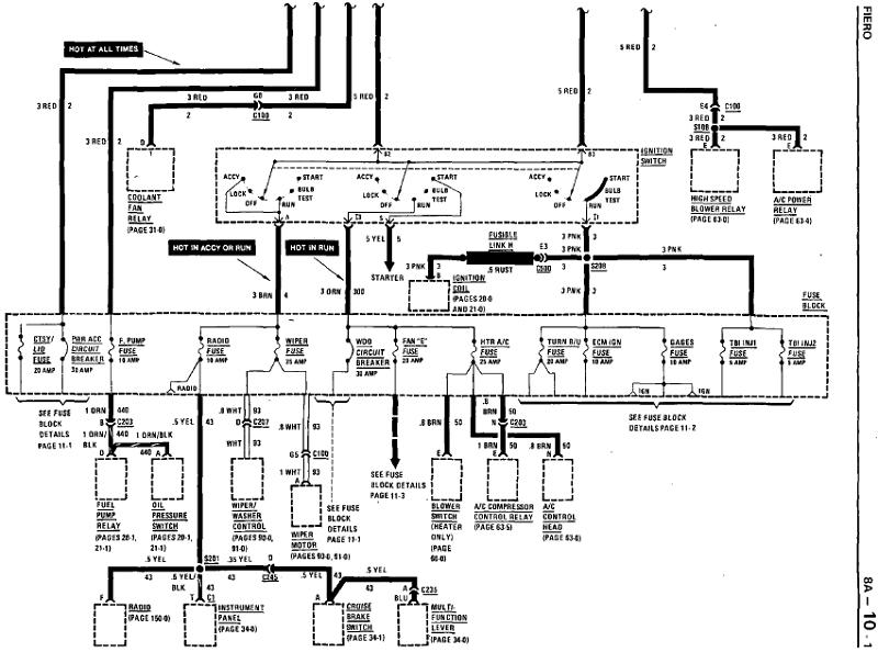

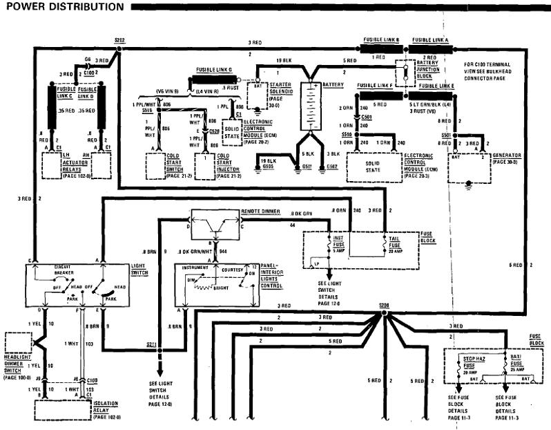

Those are all the circuits on the I1 ignition switch circuit. You also wouldn't have power to the coil since it's on that circuit too (see the schematic above). There are two main power feeds to the ignition switch, which come from a common source (fusible link A), but you know that the link and the splice between the link and the switch is good because otherwise you wouldn't get power at the radio and wiper fuses also. So the problem can be narrowed down to the ignition switch internals, the plastic connector at the ignition switch, or the crimped connection at the fuse box.
Ok, duh me. I hadn't looked closely at the posted schematics above. If I had, I would have noticed it was the same schematics I was trying to decipher from my copy of the service manual (I literally have a 20 year old photocopy and this particular schematic was hardly readable).
I tend to lean towards a problem with the ignition switch internals, simply because the problem only occurs when I turn the key - and with that I mean everything works fine, I turn the ignition to OFF and immediately turn it back to RUN and nothing works. If it was a problem with a (loose or failing) connector the problem would occur also when driving, and that has never happened. So I guess I'll have to take the column apart.
