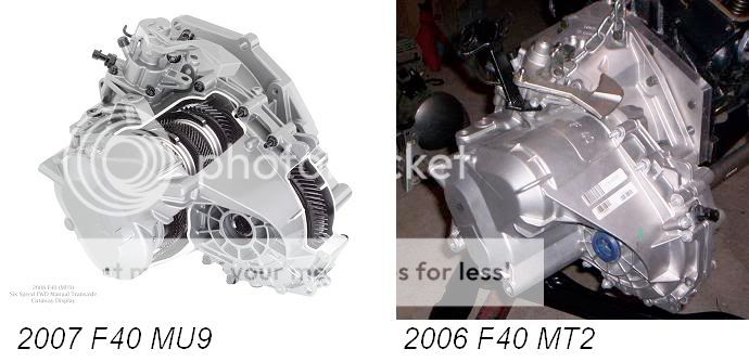

I got ya, I have an 06 for mine but with a LS3 I dont think a little gear change will make that much differance to me.
looking over the pic's the only thing I can see that stands out to me. it looks like they did away with the counter balance arm on the shift liknage.
and I can say that one of the stickers on mine has MT2 on it so maybe they did the same for the MU9

http://i544.photobucket.com...onto/0607compare.jpg
