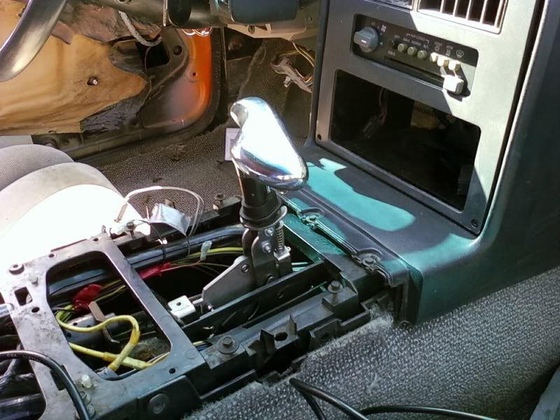

Report this Post06-27-2009 09:00 PM Click Here to See the Profile for joshua riedlSend a Private Message to joshua riedlDirect Link to This Post
I installed a universal b&m hammer shifter and it sits lower than the factory shifter. I had to cut he mounts off the stock shifter and weld them onto the ratchet shifter. I also had to make the shift arm on the trans adjustable to get the throw right. This is on a 4t65ehd. I also mounted switches to run the trans without a computer

Report this Post06-28-2009 02:34 AM Click Here to See the Profile for KekipiSend a Private Message to KekipiDirect Link to This Post
I used one on My 86 SE. Because Most trannys are forward of the vehicle the cable exits from the front. Boat Shifters exit the rear and would be kinder to our cars. I bought a 10' cable from B&M, rapped it around the console going counter clockwise back around through the tunnel and to the 4T60.

I welded on the fiero brackets and used the stock cable.

I don't think that would work on the shifter I used. Park would be L1 on tranny and to put it in Park You have to put it in L1. But then again Mine was originally a 5 speed so I didn't have a stock one to use.

Report this Post06-29-2009 01:51 PM Click Here to See the Profile for fieromadmanClick Here to visit fieromadman's HomePageSend a Private Message to fieromadmanDirect Link to This Post
Here is joshua riedl's shifter...
Where it connects to the stock cable and the switches to control the trans...

It gives me the ability to run a 4t65e-hd without a computer and without missing a shift or accidentally going into neutral or reverse.

Nice! Thanks for the pics and info.

Pressure fails open. Solenoid switches are seen in the picture and the torque converter is on a switch. It's the orange coupe choptop in the 2009 dells picture thread. As far as I can remember I drove I there.
