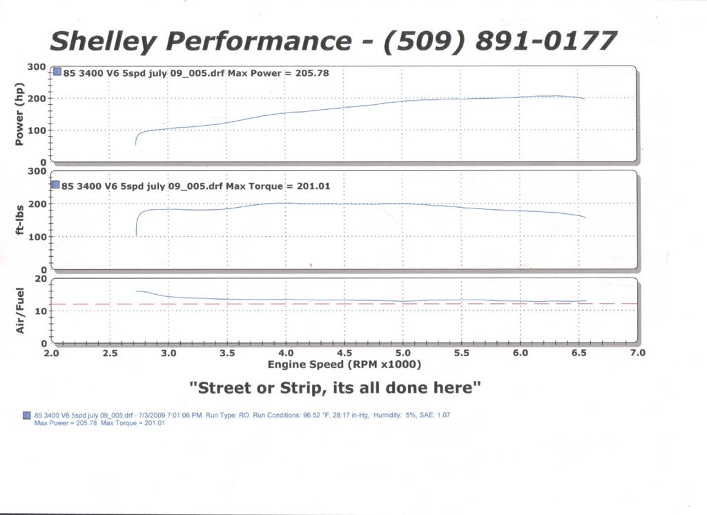

Report this Post08-05-2009 11:59 PM Click Here to See the Profile for FierokingClick Here to visit Fieroking's HomePageSend a Private Message to FierokingDirect Link to This Post
Fieroking
2150 posts
Member since Jun 2002
After finding the wiring problem this is what see pulled on the dyno
3,4 DOHC from a 96 Pontiac GTP, ECM from 97 Monte Carlo on an 88 Cradle with a FWD Getrag.
Joe Sokol
85 SE Daily driver with a 3.4 DOHC build on the road
88 Formula/GT 4.9 Allante Intake (My Baby)

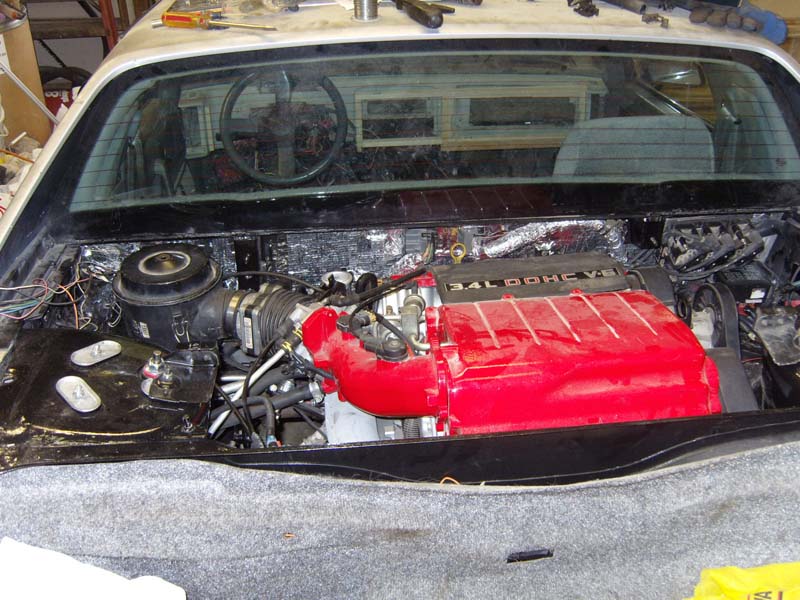

dsnover
Posts: 1668
From: Cherryville, PA USA
Registered: Apr 2006
Report this Post08-06-2009 10:23 AM Click Here to See the Profile for dsnoverSend a Private Message to dsnoverDirect Link to This Post
What was the ECM model that you used? I've got the same combination (96 motor, FWD Getrag) to be transplanted into either an 87 or 88 GT (whichever is in better condition). The wiring and ECM issues are what I'm wrestling with. I'd like to go OBD II. What did you program it with? Can you post more pics of the wiring you did?
Thanks
