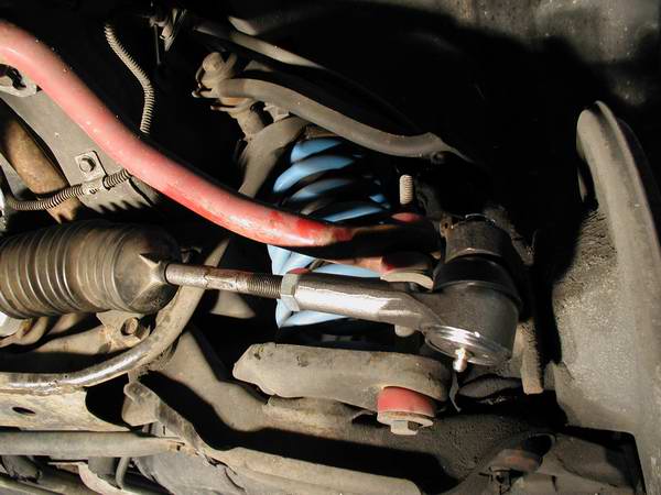

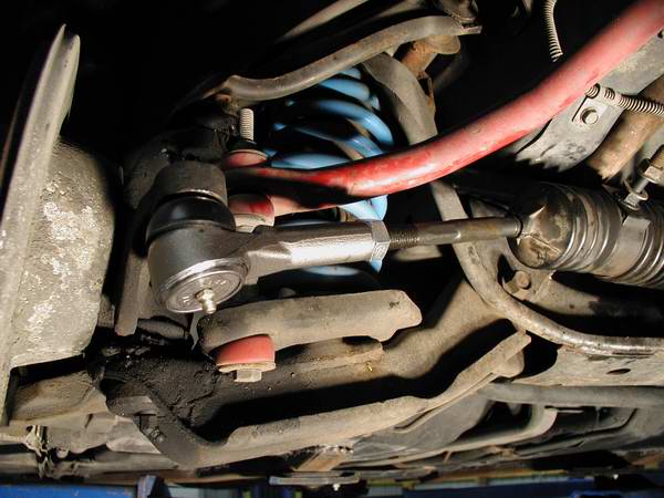

Not sure if this will help, but here are some pictures of the Addco front sway bar. Notice the curve of the bar and the direction it is relative to the A-arm. The end links should fit perpendicular to the arm hole.
Paul

Report this Post06-08-2009 08:57 AM Click Here to See the Profile for jon mSend a Private Message to jon mDirect Link to This Post
thank you, paul
the picture tells a thousand words
