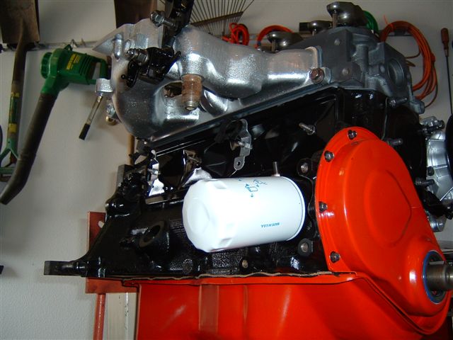

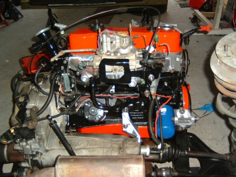

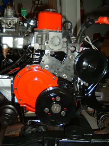

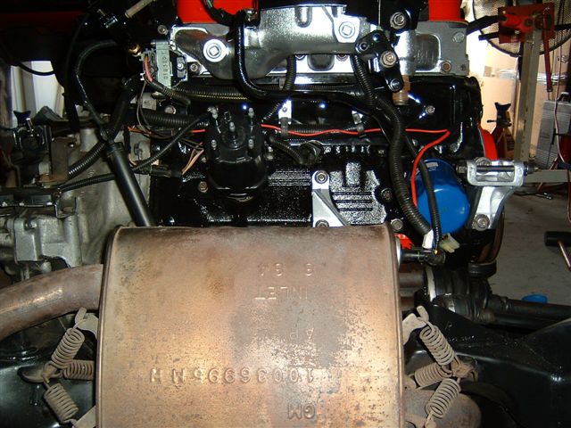

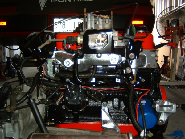

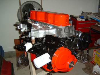

I remember someone posting about a misalignment causing their belt to squeal once. Maybe a washer or shim will do the trick. I am including some pictures from my Duke rebuild. I tried to pick out any that show the alternator bracket. I hope it helps.
