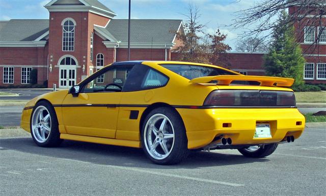

18" on a Fiero? All day long. These are a +38 offset. No rubbing at all with the 1988. Same wheels and tires on the 1987 has a tiny rub at full turn. Not bad at all.
[This message has been edited by sjmaye (edited 05-02-2009).]

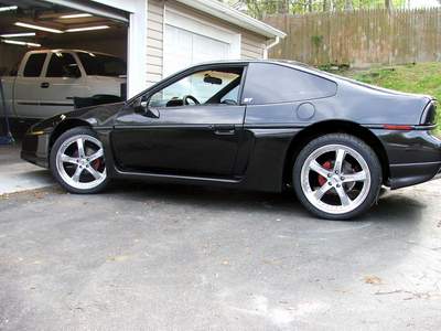

Erik
Posts: 5627
From: Des Moines, Iowa
Total ratings: 168
Report this Post05-02-2009 04:28 AM Click Here to See the Profile for ErikSend a Private Message to ErikDirect Link to This Post
Originally posted by jscott1:
Why not instead put 19" and 20" on bone stock suspension??
Who's car is that and what are the specs of the wheels and car??

That's my car, and it's running 265/35-20 on 8.5" x 20" wheels in the rear and 235/35-19 on 8" x 19" wheels on the front. Suspension is bone stock 88 suspension.

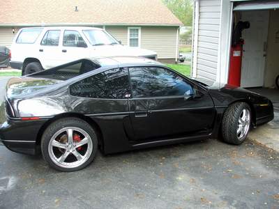

I just did 18x8 with out coilovers,The reason im going to do the coilovers is to lower the car some. offset is a 38mm

Report this Post05-04-2009 05:00 PM Click Here to See the Profile for whodeanieClick Here to visit whodeanie's HomePageSend a Private Message to whodeanieDirect Link to This Post
my 19, 20 set from BonSpeed are lighter than the stock set.
front wheel on the scale
rear wheel on the scale OOPS! wrong pic. the rear was 28.8 lbs.
and mounted on the car
[This message has been edited by whodeanie (edited 05-04-2009).]

Bozzie
Posts: 1188
From: Plainville,Ct. U.S.A
Registered: Oct 2007
Report this Post05-05-2009 01:20 PM Click Here to See the Profile for BozzieSend a Private Message to BozzieDirect Link to This Post
Sure !! 18x8 front and 18x9 rear, no problems
