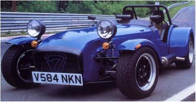

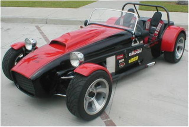

I have always wanted to do a Lotus Super 7! I now require pics of your idea. I had to wipe up the drool on the keyboard just reading your idea. The Caterham is a great car also. Just love the thought of sitting that low with a super light car. Corners, here I come!
The Lotus:
The Caterham:
