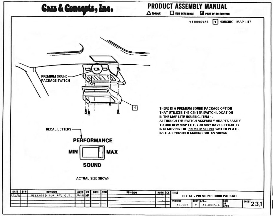

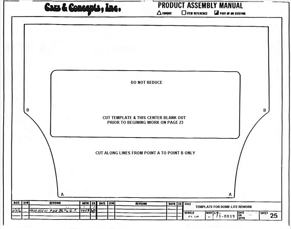

I don't have the install manual handy or I'd try to post the page. If I recall, there was a template to place on the OEM map light assembly and you'd basically cut the corners off, and place that cap on it to cover the butchered oem map light. The one I have was done FAR worse then yours. They actually removed the switches and hot glued them to that cap. Count yourself lucky. But.. yeah, the "factory" way was to cut up the OEM one and cover it with the trim cover.

Here ya go. These are the instructions and template:
