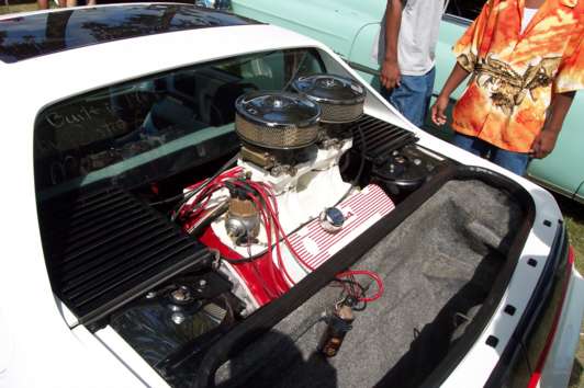

Russ Fiero
Posts: 32
From: Windsor,Ill,USA
Registered: Dec 2007
Report this Post01-02-2008 11:24 PM Click Here to See the Profile for Russ FieroSend a Private Message to Russ FieroDirect Link to This Post
How about tranverse.

Report this Post01-03-2008 07:07 AM Click Here to See the Profile for fieroguruSend a Private Message to fieroguruDirect Link to This Post
Hey Russ! Glad you decided to join and post after lurking for years!

Report this Post01-03-2008 07:59 AM Click Here to See the Profile for engine manSend a Private Message to engine manDirect Link to This Post
Russ that is a great looking job it looks like a lot of time went into geting that in there transvers what trany did you use I know that I will be sticking with the toronado trans i feel it will go in the car easyer

Report this Post01-03-2008 05:44 PM Click Here to See the Profile for flames4meSend a Private Message to flames4meDirect Link to This Post
looks like a clean swap there Russ, with the custom tube cradle and retaining a stock fiero trans, but Im wondering why you chose the izuzu 5-speed?? thats one of the weaker trannys that came in fieros. is it shorter then the others so it can fit betweeen the frame rails? I can only imagine how much cutting and custom work you had to do the the pass side frame to get the extra iron to fit in there. good craftsmanship Russ, Im impressed with those pics!

engine man
Posts: 5309
From: Morriston FL
Registered: Mar 2006
Report this Post01-04-2008 06:12 PM Click Here to See the Profile for engine manSend a Private Message to engine manDirect Link to This Post
Looks nice v8fiero400 what engine 427 454 have you had it at the drag strip and whats it run what trany is in it

RichLo
Posts: 177
From: Mankato, MN
Report this Post01-04-2008 10:53 PM Click Here to See the Profile for RichLoSend a Private Message to RichLoDirect Link to This Post
correct me if Im wrong but I dont think that picture was of v8fiero400's car, I believe one of the original transverse sbc engine swap creators built that car with a 396 a while ago... Zumalt or Archie.
1987 Pontiac Fiero GT
418ci SBC dual stage Nitrous injected
built 5-speed getrag
Yeah, that was Zumwalt's car from the late 80's, it ran a th125 for the trans.
Joe
