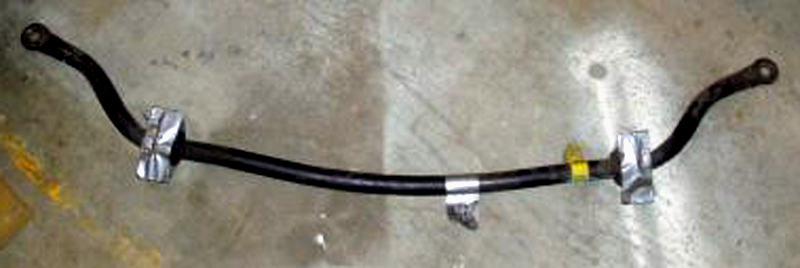

Here's a link to a used Fiero Store rear bar for a good price on E-Bay
Not mine by the way.

Concerning using the Grand Prix front sway bar on the rear of the Fiero, all the Grand Prix sway bars should be the same from 98-02. Those are the years that reportedly fit. Brian my partner on the swaps has one of these in his shop and we will be trying the install this week or next. Could end up being an inexpensive quality solution for a rear sway bar.
I know this is an old thread, but if you see this Dennis, how did the Grand Prix sway bar work out?
Is this what the front sway bar from the Grand Prix looks like?
I was not convinced that the fit of the GTP sway bar would be as good and just purchased another Addco. Therefore I am not certain how well the GTP bar will work. It might be worth risking a few bucks but I just took the easy way out. We know the Addco bar works and the GTP might. I just didn;'t have the time to fiddle but adapting the GTP bar looked pretty easy to do. .
