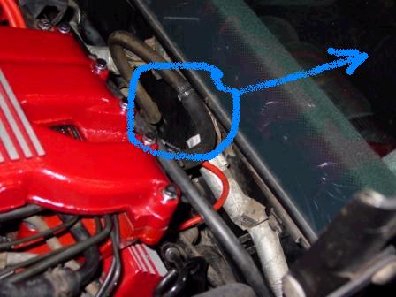

My car is an 86GT and the engine came out of an 87. I had to take the vacuum hose I think its for the brake booster, and use a coupling to make it fit. Basically my 86 has a small hose, but the vacuum line that is on the engine needs to bigger hose (Make sense?) So if anyone has the part I need let me know. Going to post it in the mall section.
Here are two pics of the hose I am talking about.
The actual part I need, just smaller opening.
Thanks,
Ken~

On the first pic i notice that the hose , not the intake side , but the other end is supposed to connect on the firewall , that's the way it is on mine . 88 Gt 2.8L
i took your pic as an example

Correct it does connect to the firewall and run to the front of the car. It also then connects to the medal line that runs under the plenum and connects to the side of the plenum next to the thermostat housing. Mine is too big for the hose that is attached to the firewall. In order for me to make this work I went and bought a bigger hose to connect to the medal plenum tube, and then used a coupler to attach it to the smaller hose that is attached to the firewall. This works, but does leak a little bit.
I have a forum member sending me the correct part now
Thanks,
Ken~

II it's leaking that is a vacuum lost and also, that is the vacuum for the brake booster
