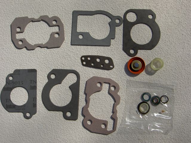

The TBI is much easier to rebuild than a carb. Here's what's in a typical rebuild kit:
Easy to follow instructions are included with the kit:
I don't recommend messing with the idle stop screw though.
