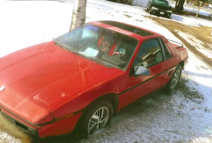

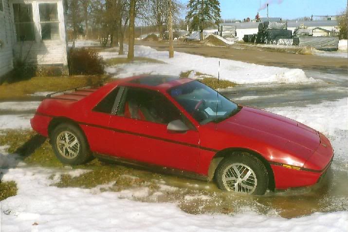

So, with that in mind, mine only has a single muffler, no Aero body parts, and a luggage rack. Here's a picture of my actual car.
It's a 2M4.

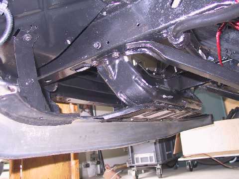

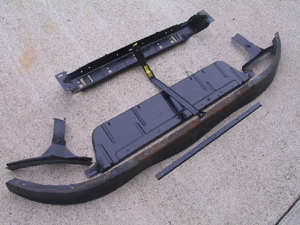

Yup, with some of the brackets for teh front end and gt honeycomb parts, I made this conversion...

Looks like an 84 Sport Coupe, what are the 5th and 10th characters in the VIN?
5th character: E = Coupe, M = Sport Coupe, F = SE
10th character: E = 84, F = 85, G = 86
If you want to put a GT body on it, you'll be able to reuse the hood and the roof, and you should be able to keep the front fenders and door skins, I think you just need to drill holes in them to attach the aero ground effects. Not sure what mods you'll have to make to the taillight wiring, though.
An 86 SE would look like a GT, without the fastback.

Here's a pic....

From your pics it could be an 84, 85, or 86 coupe. I don't see any indication of it being an SE. If it's an original 84 it will have a center vent on the rear decklid with solid removable panels on each side of the decklid. 85 and 86 will have a solid decklid with removable vents on each side. An 84 wiring is also is set up differently in the engine compartment.
