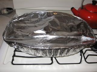

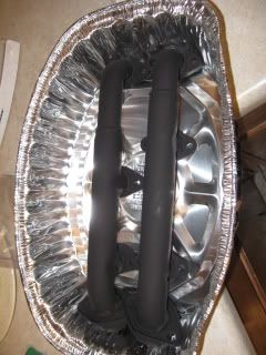

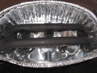

What heat was that, we use the 1300 deg stuff. Here's a tip when using VHT nad othe spray bomb hi temps, after you spray it let sit maybe 10mins and then pass a propane torch over it slowly, you can see flash over as you go. That wont fullly cure it but should with scraching. That stuff comes off so easy, one lil bump and you have to spray the spot again. Also, if youre going to use heat-wrap, put lots a nd lots of coats of paint your headers, even then they will still rust-out a lot qucker than with no wrap. A good pro ceramic job is best for long life.
Yes I used the 1300* VHT (black). I used several coats and put it on pretty heavy each coat. Let them sit out in the West Texas Sun for several hours between coats and heat treat. I think it is also important to keep the rattle can as warm as possible and to shke the crap out of it even while spraying. Also,after running them on the car for awhile, I took em off and wrapped them with header wrap then used the Header wrap sealer and more heat treat. I read a few threads where people thought that there would be a rust issue. Out here in West Texas, moisture is not an issue.
