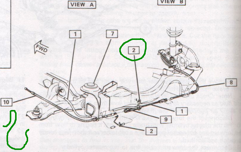

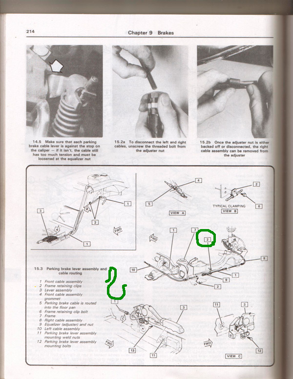

This is a scan from an early Haynes Service Manual.
You may be missing one of the wire hangers labelled # 2 in the diagram.
The shape of it is drawn in green.
I fixed mine with a piece of stainless wire bent to shape.
I hope this helps.
