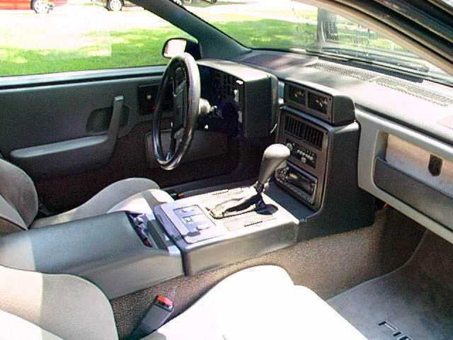

As noted it is for looks and erganomics. Blacktree's write up is what you need to do.
The shortened shifter is a little more comfortable when resting your hand on it while driving. Also if you change shift knobs it could help as well. When I had an auto I liked the "cobra head" shifter. With the stock height shifter it was too high and looked goofy. I shortened the shifter and it looked/felt better. In the before pic you can see that the top of the shifter is almost as high as the center vents. In the after pic it is near the bottom of the A/C controls.
Here is the "Before" pic:
Here is the "After" pic:
