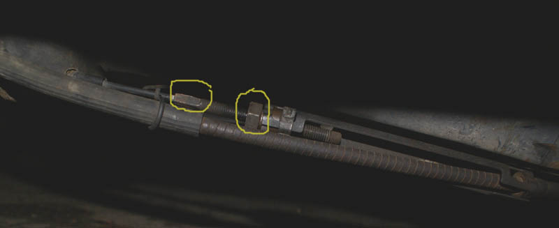

The adjustment is just left of center in the back. the 3 cables come together you can see that one of the cables from the lfet is threaded and the cable end is square. you can hold this square part and turn the nut that is on the threaded shaft to tighten. I live on the east side of Fort Worth if you can't figure it out come by and I can show you. I can take some pics later if you are too far away.

None of mine have two nuts.
The circled place on the left is where to hold the one on the right is the nut to adjust.
Let me know if you still need help.
