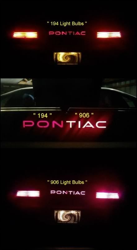

I also wanted the " PONTIAC " on the back of my car to be brighter so here are a few pics of what I did. Top pic is of the 194 light bulb at night in my garage.
The second pic is of the 194 and 906 light bulb. The 194 is on the left and the 906 is on the right. Big difference. The bottom pic is of the 906 light bulb.
