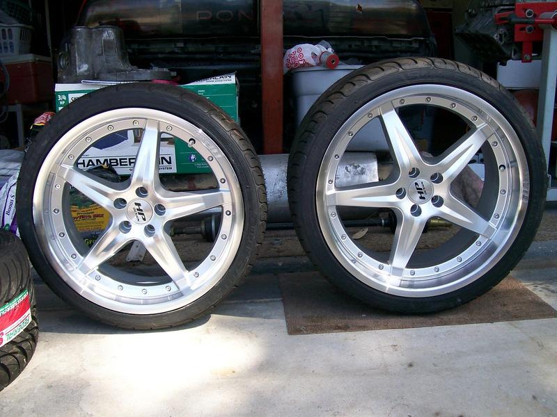

I would tend to agree with this assessment. I have two Fieros. I just put a set of 18"x8" wheels on my 87. Looking from the side it looks good, but the rear somehow looks a hair smaller. It is probably as you say, a result of the wheel against the wheel opening.
The wheels I am looking at for the 88 are not available below 18, so I am looking at 18 and 19's. I hate the though of the super low profile I will need on a 19" wheel to have the speedo accurate. Sure wish there was a gear I could change or something so I could use a slightly higher profile. The bumps would also be easier on my old back.

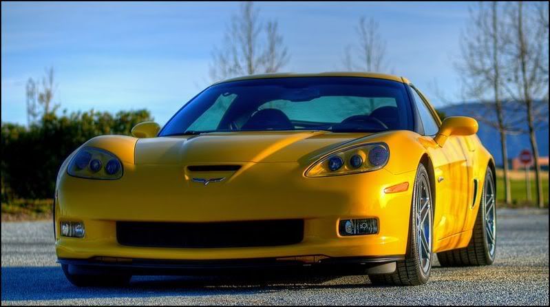

I was just reviewing the post that got me looking at staggered wheel sizes in the first place. I looked more closely at the pic. I do see the difference. These are 19 and 18. Tread height doesn't look bad at all. I am now looking at a set just like these or maybe the split 5.0's.
NOLUCK13
Posts: 37
From: SouthEastern Illinois
Registered: Dec 2008

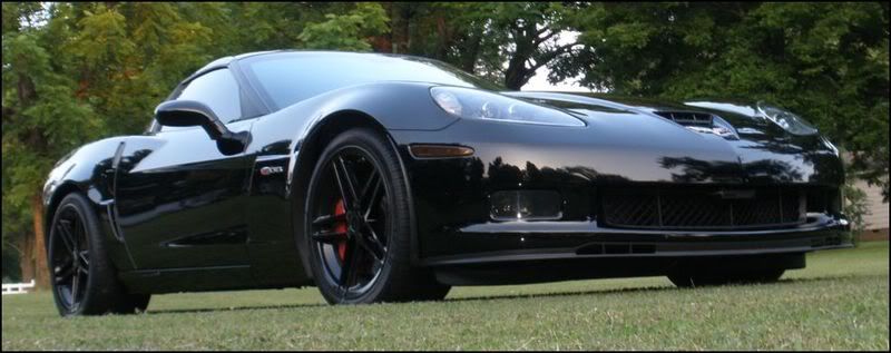

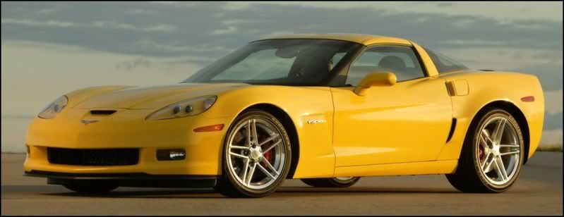

Report this Post02-21-2009 06:07 AM Click Here to See the Profile for NOLUCK13Send a Private Message to NOLUCK13Direct Link to This Post
Originally posted by sjmaye:
So what do you do? Make the back tire diameter match the original diameter and get the tires in the front to match that profile? This should make the speedo correct and give the desired effect.
Anyone have a pic that really demonstrates the impact on appearance from using staggered wheel sizes?
The black Z06 is mine but the yellow one I had in my file. You can see profile appearance in these shots. They look 10 X better in person, in fact,
when I gas up I walk around the car and look at the tire size differance. My Z06 has the fattest back tire I have ever seen in person ! ! !
Front Tire : 275/35ZR/18 Rear Tire : 325/30ZR/19
