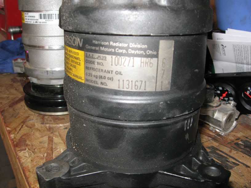

This is out of my 88 Formula:
It is an HR6. The last one I bought for my 86 was a remanned from Autozone and it used the stock O ring setup. The one I installed on my 88 was the new style with sealing washers. It came with various sealing washers and instructions for installing them. If your system has already been converted to R134 then you should be set. Just be sure to add at least 4 oz of PAG oil before you install it in the car.
