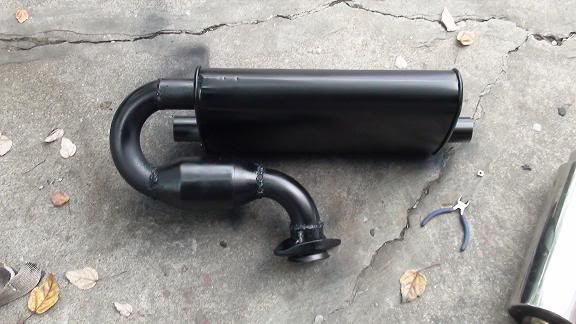

Report this Post01-28-2009 09:49 PM Click Here to See the Profile for mrjohnishomeSend a Private Message to mrjohnishomeDirect Link to This Post
Check out my system (for a dohc)
It consists of an ebay cat, a walker stock replacement muffler for a camaro, and a set of hedman hot tip resonator tips. Along with some crappy welding :P
It is also MUCH quieter than my previous exhaust, needless to say, it was just plain loud.
I got the tips from amazon.com for like $25 each. Great deal.

Originally posted by jetman:
Yeah and those huge oversized sunglassses that the old folks wear, You know the ones, they're big, square and shield all the way up to the ears, you could view a solar eclipse with them.
But seriously, you may wish to read this thread where we talked about muffler inserts and tube mufflers.
I've seen both up close at the Woodward Dream Cruise, open headers that were very mellow until you hit it, then they were authoritative. Just an alternative way of looking at exhaust noise.
Jetman- I read the thread linked above. I was particularly interested in your post about the sound difference between your 86 4speed vs. your 87 auto. Both had new exhausts, but sounded very different. The 86 4 speed sounded fine, but 87 auto sounded like it had a big whole in the muffler.
Exactly the issue I have. My 120K mile 87GT 5speed with original exhaust sounds fine, but my 88GT auto with with the old factory or new FS original-style exhaust sounds ratty.
Some of the pics in the old thread were missing. Since your situation was so similar to mine do you have any tips for me?
