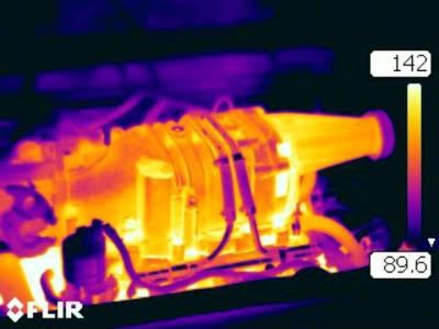

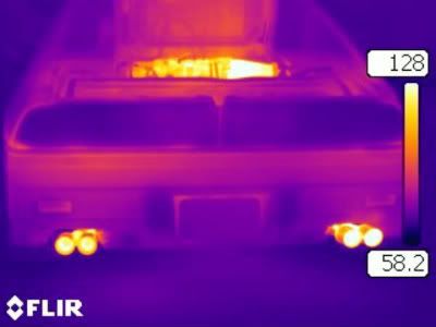

Originally posted by sabooo:
Just for fun - some Thermal images of my 3800sc engine. It is cooling down in the photo. I was looking for the true "hot spots" in the compartment attempting to ferrett out an idle issue.
Cheers,
Sabooo
Thanks again Sabooo!

The super charger gets as hot if not hotter than the engine block.
Just take a look at the PICs above. The gear housing in the SC is as hot as the exhaust tips. Exhaust tips wont hold high temp paint for to long.
I don't know how long or how hard that SC was run before the pics, but the bottom line is that the SC can get very hot. There is no way to cool down the SC without some sort of water jacket cooling system like the engine has. Both friction and compressing air heat it up from the inside out. The temp you feel on the outside is lower than the temps on the inside. The outer cooling fins on the SC radiate the internal heat to the engine compartment. If the engine compartment is hot, then the efficiency of the colling fins drop. That just means the SC will get hotter than an open air setup, but it will still build up heat from the inside and radiate it out.
