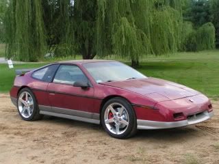

Buy a set of wheels for the stock 5 x 100 pattern, you don't want to pay for the conversion work that I had done (I had a hook up at a machine shop).
And as a side note, I found the 18/19 combo to be a tad too big for a stock-bodied Fiero, so I will be stepping down to stock C5 wheels (17/18 combo) as pictured by sjmaye.
Christian
87 Pontiac Fiero GT Burgandy/Silver 5.7L ZZ4 5spd, 88 suspension, C6 polished wheels, C5 Z06 brakes, Konis, poly'd, Spec Stg 3, LED taillights
