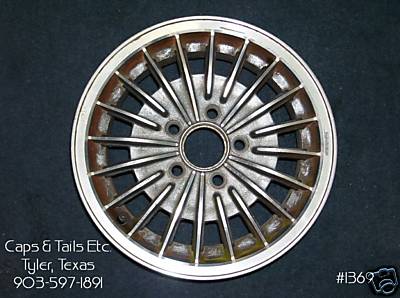

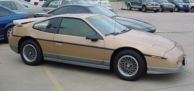

Report this Post01-05-2009 03:36 AM Click Here to See the Profile for PaulJKSend a Private Message to PaulJKDirect Link to This Post

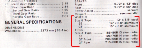

well, I hate to see ANYBODY provided with incorrect information. I normally trust the literature first or post what i know is true from working on my cars. Next, I'll trust only a handful of the people here; I've seen too much trash posted by people with long green bars under their names. (you wanna see a bunch of useless crap posted, read through the threads and try to decide if the radiator cap is vented or unvented - radiator cap = cap on radiator, not cap on engine covering thermostat). SO, maybe we can use this thread to straighten out the wheel stuff.
Let's start with the wheels that were offerred and see if people can provide VERIFIABLE references; maybe checking the sizes of these wheels if they actually have them on their car and can either measure them or verify the stamping in the rims.
This is an 85 and is supposed to have 14 x 6 wheels as shown. Anybody have these and wanna post their size - maybe a pic of the rim stamping ?
These gray honeycombs came on 86 and 87. Safe to assume they are all the same ? Either 15 x 6 or 15 x 7 ? Pics ?

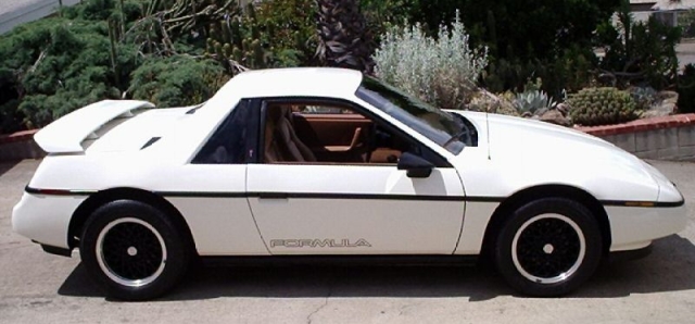

These black honeycomb came on 88 and are two different sizes; wide on back and narrow on front. Anybody wanna verify these if they have them ?
I'm curious to see of people have different widths of wheels that look the same (for example, one guy has 15 x 6 grey honeycombs and another guy has 15 x 7s).
this COULD get interesting (or maybe the 86 manual is just wrong). The 87 and 88 manuals do not have the wheel widths listed. How wide are the two size black honeycombs ?
[This message has been edited by PaulJK (edited 01-05-2009).]

My '84 with 14" aluminum wheels is 7" out side of lip to out side of lip. Measured them twice to make sure (not on car).
They look like these:
Bob

I have the 86-87 type silver wheels on my 86 which look like this:
And this is what I found behind it:

Originally posted by PaulJK:
That's what my new 86 looks like, minus the tinted windows.
