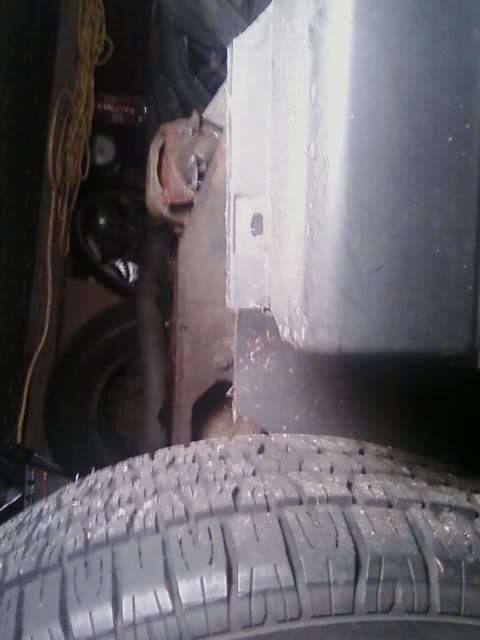

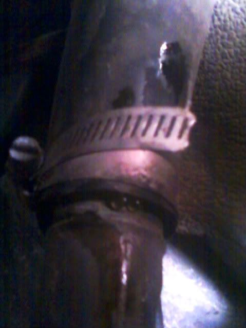

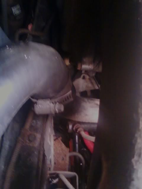

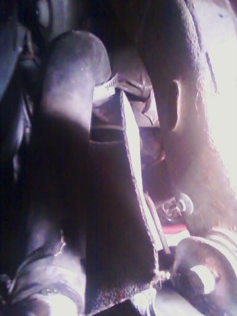

How would i go about replacing this tube that is leaking coolent??? can i unscrew the clamps on each end or will it spill out coolant eveywhere or is it empty?? please help i need to fix it here are some pictures of it
Can i just take that old one off and see if it is cracked or will coolant go everwhere??

Also, when you get the hose off, inspect the tube that goes up to the fill pipe on the motor. These will corrode around where the hose clamps. If it is too coroded, the hose will not seal. In one of your pictures, it appears to be leaking bwteen the tube and the hose. Before you drain it, you might try adding another "new" clamp above or below the old clamp and tighten it good and tight. This may be a quick simple cheap fix to get you by until the weather/financial situation gets better. Might be worth a try.

If you need to hold it off a bit take off the clamp slide that tube on a little further then use a new clamp to clamp it straight. looks like the back side of the clamp is on the upper rib.

Just noticed that too. The second pic looks like the hose isn't all the way on.

Man you guys are good! I looked at that pic a bunch of times and I never noticed that. The only thing better than 1 Fiero mechanic is 2 Fiero Mechanics or 3 or 4 or...... lol.

It's mostly a been there done that thing. I know I've tightened one on and didn't pay attention that the clamp got on the rib. Then there's about 10% of the clamp not holding the rubber down tightly. Also the hoses need to go all the way to the second rib to seal their best. This gives you one rib that presses into the rubber at rib 1 then rib 2 gives you a stopping point and another leak stopper by flexing the rubber out a tad making that side of the clamp that much tighter. But mainly it's the get it off of the rib part for me.clamps need to be on straight otherwise their not exerting even pressure.
Dang I sound like the same guy that told me that when I asked the same question as above. Except mine was on a new hose new clamp new radiator. Massive leak.
Oh and that clamp is too long. Not made for that diameter. Thus causing the installer to allow it to twist as he tightened it up. when a clamp touches all the way around slide the clamp a bit to "seat" it. then start to tighten it.
