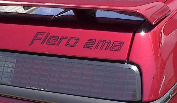

There just so happens to be one sitting in my driveway at the moment. Any time you feel like it, come on down and you can grab the pilot's seat. It's a 4.9 / 4T60E, so don't expect a 12 second quarter mile or anything, but it scoots down the road pretty good. The Honda boys never see it coming. They do, however, see it going And its getting around 20 mpg around town, so I can't complain too loudly. The only issue we have in El Paso is getting around the smog nazis....but there are ways around that too.
I need to get under the decklid on it this weekend...it's developed a squeaking drive belt. Only does it cold....squeak goes away after about 5 minutes of driving it, but it's annoying me. I may have to adjust how my tensioner is mounted....or the belt may just be getting old and glazed. At any rate, here is one of them.....mine in the center, flanked by Pat's Formula on the left and Jan's on the right on TransMountain Road
The only hint to what lurks beneath.....
